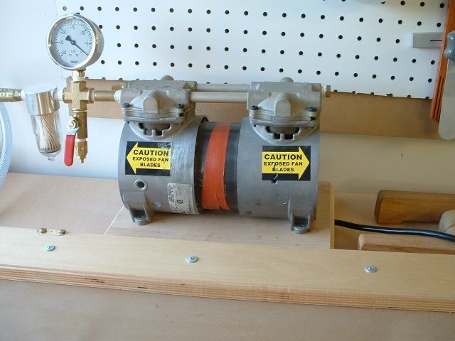

I've used the little venturi pump from LMI for the last 6 years or so ... works well. I've switched over to a continuos vacuum pump system which I like much more. I use the refurbished Thomas pump from joewoodworker.com. Great little unit:

I have the Joe Woodworker set up with the GAST pump. It works flawlessly.

I have been using the vacuum pump system as per joewoodworker's plans for over 3 years with perfect results.
I bought a used Gast pump on eBay before he started selling them on his site.
It is much quieter than a venturi system, especially when you use a large auxillary tank to reduce the pump cycling.
